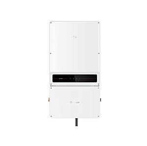

GoodWe GW60K-SMT-US Grid Tied Inverter
This inverter can only ship via freight truck. It can NOT ship via UPS or USPS. Please email us or give us a call if you have any questions.
Get the most out of your solar panels with the GoodWe GW50K-SMT-US inverter! Designed for medium and large-scale commercial installations, this inverter is perfect for businesses looking to generate environmental-friendly power and increase their return on investment. With an 180V-980V wide input operating voltage range and up to 6 MPPTs, the GoodWe SMT-US Series inverter is a reliable and efficient choice for your solar energy needs.
  • Remote data monitoring
  • Multi-protocol compatibility
  • 180V-980V wide input operating voltage range
  • Fuse-free design
  • Type II Surge Protection for both DC and AC
  • IP65 ingress protection
  • Maximum 15A DC input current per string
  • 150% DC input oversizing & 110% AC output overloading
  • Max. Input Voltage(V): 1000
  • Max. Input Current per MPPT(A): 30
  • Number MPP trackers/Number of Strings per MPPT: 6/2
  • Weight (lbs): 154.3
  • Nominal Out Voltage (V): 480, 3L/N/PE or 3L/PE
