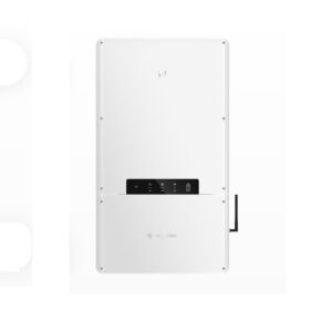

GoodWe GW9600-ES-US20 APS LAN Hybrid Inverter
The GoodWe ES-US Series is a split-phase hybrid inverter designed for residential use, supporting high voltage batteries (80-495V) with capacities from 5 kW to 11.4 kW. It offers up to 4 MPPTs, making it highly adaptable to complex rooftops. Key features include built-in optimization, rapid shutdown, AFCI, and an optional EV charger. This inverter maximizes energy production with 150% DC oversizing and allows whole-home backup for enhanced energy management and security.
Goodwe ABD (Auto Backup Device) is required for ES-US20 inverter to operate during a power outage. Without ABD the ES-US20 Hybrid inverter pared with Lynx FH-US battery can offset evening power usage when grid is present
  • Optional EV charger integration simplifies charging management
  • Options for storage including whole home backup
Technical Data:
Battery Input
  • Battery Type: Li-Ion
  • Nominal Battery Voltage (V): 300
  • Battery Voltage Range (V): 80 ~ 495
  • Start-up Voltage (V): 80
  • Number of Battery Input: 1
  • Max. Continuous Charging Current (A): 50
  • Max. Continuous Discharging Current (A): 50
  • Max. Charging Power (W): 9600
  • Max. Discharging Power (W): 10080
PV Input
  • Max. Input Power (W): 14400
  • Max. Input Voltage (V): 600
  • MPPT Operating Voltage Range (V): 50 ~ 550
  • Start-up Voltage (V): 60
  • Nominal Input Voltage (V): 390
  • Max. Input Current per MPPT (A): 16
  • Number of MPP Trackers: 4
AC Output (On-grid)
  • Nominal Output Power (W): 9600
  • Nominal Output Voltage (V): 240
  • Output Voltage Range (V): 211 ~ 264
  • AC Grid Frequency Range (Hz): 58.5 ~ 61.2
  • Max. AC Current Output to Utility Grid (A): 40.0
  • Max. AC Current From Utility Grid With EV Charger(A): 40.0
AC Output (Back-up)
  • Back-up Nominal Apparent Power (VA): 9600
  • Max. Output Apparent Power with Grid (VA): 9600
  • Max. Output Current (A): 40.0
  • Nominal Output Voltage (V): 240 / 120
  • Nominal Output Frequency (Hz): 60
General Data
  • Operating Temperature Range: -31°F ~ +140°F (-35°C ~ +60°C)
  • Weight(LB): 84.9
  • Dimension (W × H × D): 19.1 × 35.4 × 7.5 in (485 × 900 × 191.5 mm)
