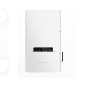

The GoodWe ES-US Series is a split-phase hybrid inverter designed for residential use, supporting high voltage batteries (80-495V) with capacities from 5 kW to 11.4 kW. It offers up to 4 MPPTs, making it highly adaptable to complex rooftops. Key features include built-in optimization, rapid shutdown, AFCI, and an optional EV charger. This inverter maximizes energy production with 150% DC oversizing and allows whole-home backup for enhanced energy management and security.
  • Optional EV charger integration simplifies charging management
  • Options for storage including whole home backup
