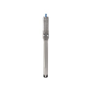

The SQFlex system is a reliable water supply system based on renewable energy sources, such as solar and wind energy. The SQFlex submersible pumps are fitted with a permanent magnet motor, which enables the most flexibility as to its energy supply and performance. It can be combined and adapted to any need according to the conditions on the installation site. The pump's innovative design allows it to be powered with both AC and DC sources without making any modifications to the pump or adding additional equipment. The Gundfos SQFlex line of pumps are perfectly suited for both continuous and intermittent use, making them useful for most remote watering applications.
Features and Benefits:
- Renewable energy supply: solar panels or wind turbines
- Built-in electronics, easy installation
- Reliable water supply
- Low operating costs
- Dry-running protection
- Built-in motor protection
- High Efficiency
- Maximum Power Point Tracking (MPPT)
- Wide voltage range
- Built-in sand shield
- Two year warranty
- Model Number: 16 SQF 10
- Centrifugal pump
- Supply Voltage: 30-300 VDC or 90-240 VAC at 50/60 Hz
- Maximum Gallons per Minute: 19.5 GPM
- Maximum Head: 230 ft.
- Discharge: 1.25" NPT
- Weight: 21 pounds
- Dimensions: 38" length and 3.9" wide
