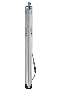

Grundfos SQFlex Solar Water Pump Model 22 SQF-220
The 22 SQF-220 is a solar submersible pump designed for water supply from shallow wells, with low daily flow requirements. Because of its small size, it is a perfect match as a replacement pump for a wind-powered or hand-pump water supply, and the pump also excels as part of a battery system. This makes it the most competitive solar water supply solution on the market for these small-scale applications.
Features and Benefits:
- Renewable energy supply: solar panels or wind turbines
- Built-in electronics, easy installation
- Reliable water supply
- Low operating costs
- Dry-running protection
- Built-in motor protection
- High Efficiency
- Maximum Power Point Tracking (MPPT)
- Wide voltage range
- Built-in sand shield
- Two year warranty
- Model Number: 22 SQF-220
- Centrifugal pump
- Supply Voltage: 30-300 VDC or 90-240 VAC at 50/60 Hz
- Maximum Gallons per Minute: 35 GPM
- Maximum Head: 328 ft.
- Discharge: 1.5" NPT
- Weight: 19.3 pounds
- Dimensions: 37" length and 2.9" wide
