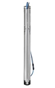

Grundfos SQFlex Solar Water Pump Model 5 SQF-8
The 5 SQF-8 is a solar submersible pump designed for water supply from shallow wells, with low daily flow requirements. Because of its small size, it is a perfect match as a replacement pump for a wind-powered or hand-pump water supply, and the pump also excels as part of a battery system. This makes it the most competitive solar water supply solution on the market for these small-scale applications.
Features and Benefits:
  • Renewable energy supply: solar panels or wind turbines
  • Built-in electronics, easy installation
  • Reliable water supply
  • Low operating costs
  • Dry-running protection
  • Built-in motor protection
  • High Efficiency
  • Maximum Power Point Tracking (MPPT)
  • Wide voltage range
  • Built-in sand shield
  • Two year warranty
  • Model Number: 5 SQF-8
  • Centrifugal submersible pump
  • Supply Voltage: 30-300 VDC or 90-240 VAC at 50/60 Hz
  • Maximum Gallons per Minute: 9.5 GPM
  • Maximum Head: 130 ft.
  • Discharge: 1.25" NPT
  • Weight: 13 pounds
  • Dimensions: 39" length and 2.9" wide
