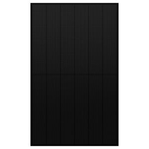

The Q.PEAK DUO BLK-G9+ 380 Watt solar module from Q CELLS features cells powered by Q CELL's zero-gap Q.ANTUM DUO Z technology, offering higher module power density and enhanced all-black aesthetics. By eliminating the gaps between cells, Q CELL module efficiency is increase in relative terms by 4%, delivering an overall efficiency of up to 20.6%. The module is also backed by a 25-year product and performance warranty that guarantees at least 85% of the nominal power after 25 years.
Q.PEAK DUO All Black G9+ 380W Specifications:
  • Nominal power: 380 Watts
  • Vmp: 37.85 Volts
  • Voc: 45.04 Volts
  • Imp: 10.04 Amps
  • Isc: 10.5 Amps
  • Module efficiency: 20.1%
  • Dimensions (inches): 72.44" x 40.55" x 1.26"
  • Dimensions (millimeters): 1840 x 1030 x 32
  • Weight: 43 lbs (19.5 kg)
