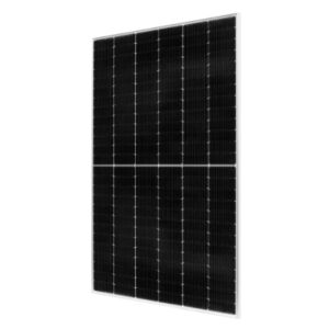

The high-performance module Q.Peak DUO XL-G10/BFG is the ideal solution for commercial and utility applications thanks to a combination of its innovative Q.ANTUM DUO-Z technology and cutting-edge cell interconnections. This 1500V UL/IEC solar module ensures superior yields with up to 490W while having a very low LCOE.
Q.PEAK DUO XL 485W Specifications:
  • Power at Mpp: 485 Watts
  • Isc: 11.16 Amps
  • Voc: 53.63 Volts
  • Imp: 10.63 Amps
  • Vmp: 45.63 Volts
  • Efficiency: 20.9%
  • Cell: 6 x 26 monocrystalline Q.ANTUM solar half cells
  • Maximum system voltage: 1500 Volts
  • Connector type: MC4
  • Dimensions: 87.2" x 41.1" x 1.38" (35mm)
  • Weight: 64.2 pounds
Warranty: 12 year product warranty, 30 year performance warranty.
