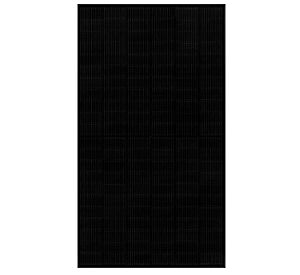

Hanwha Q.PEAK DUO BLK ML-G10+400W Solar Panel
With a higher efficiency rate than previous series, the Q.PEAK DUO BLK ML-G10+ is the first 400W module for the residential market and takes high performance to a new level. The G10+ module utilizes Q CELLS’ zero gap Q.ANTUM DUO Z technology to boost module efficiency up to 21.4%. The module is also backed by a 25-year product and performance warranty that guarantees at least 86% of nominal power up to 25 years.
Benefits:
  • Breaking the 20 % efficiency barrier Q.ANTUM DUO Z Technology with zero gap cell layout boosts module efficiency up to 20.9 %.
  • The most thorough testing programme in the industryQ CELLS is the first solar module manufacturer to pass the most comprehensive quality programme in the industry: The new “Quality Controlled PV” of the independent certification institute T.V Rheinland.
  • Innovative all-weather technologyOptimal yields, whatever the weather with excellent low-light and temperature behavior.
  • Enduring high performanceLong-term yield security with Anti LID Technology, Anti PID Technology, Hot-Spot Protect and Traceable Quality Tra.Q™.
  • Extreme weather rating High-tech aluminum alloy frame, certified for high snow (5400 Pa) and wind loads (4000 Pa).
  • A reliable investment Inclusive 25-year product warranty and 25-year linear performance warranty.
Q.PEAK DUO BLK ML-G10+400W Specifications:
  • Power at Mpp: 400 Watts
  • Isc: 11.14 Amps
  • Voc: 45.3 Volts
  • Imp: 10.77 Amps
  • Vmp: 37.13 Volts
  • Efficiency: 20.4%
  • Cell: 6 x 22 monocrystalline Q.ANTUM solar half cells
  • Maximum system voltage: 1500 Volts
  • Connector type: MC4
  • Dimensions: 74.0" x 41.1" x 1.26" (32mm)
  • Weight: 48.5 pounds
Warranty: 25 year product warranty, 25 year performance warranty.
