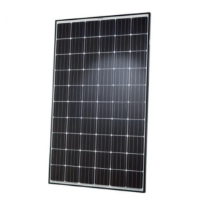

Hanwha Q.PEAK G4.1 305 Watt Monocrystalline Solar Module
The Hanwha Q.Peak 305 Watt module is designed and engineered in Germany drawing upon many years of solar cell production technology. Their modules offer improved power yield, reliability, and generates electricity at a low cost. Suitable for both grid-tie and off-grid solar systems, battery charging, and mobile applications. The frame is designed to withstand high wind and snow loads, which makes the panel a good choice for harsh environments. By producing their own silicon ingots and wafers, Hanwha is able to lower the total cost of the module, making them very competitive with alternative brands. Great for small systems and large commercial projects when installation time is a factor. The built-in MC4 connectors make connecting modules safe and fast. The module is backed up by a 12 year product warranty and a 25 year power warranty.
Q.PEAK G4.1 305 Specifications:
  • Nominal power: 305 Watts
  • Number of cells: 60
  • Vmp: 32.41 Volts
  • Voc: 39.76 Volts
  • Imp: 9.26 Amps
  • Isc: 9.77 Amps
  • Module efficiency: 18%
  • Dimensions (inches): 65.7" x 39.4" x 1.26"
  • Dimensions (mm): 1670 x 1000 x 32
  • Weight: 41.45 lbs (18.8 kg)
Warranty: 12 year product warranty, 25 power warranty
