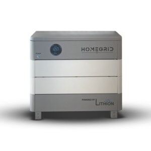

HomeGrid 2 Modules Stack'd 9.6 kWh
This home battery is modular with 4.8 kWh increments, providing a capacity range of 9.6-38.4 kWh per Stack. This also allows for easy servicing and future expansion. With continuous output at up to 15 kW, and a surge of up to 24 kW for 10 seconds, true full-home backup is here with a 30-60 minute installation.

  • Total Energy: 9.6kWh
  • Continuous Power Output: 9.6kW
  • Capacity: 200Ah
  • Nominal DC Voltage(V): 48V
  • DC Voltage Range(V): 46-56V
  • Enclosure Rating: IP55
  • Dimensions(WxDxH): 29" x 15.75" x 25.25"
  • Weight: 304 lbs
