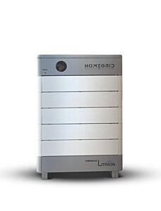

HomeGrid 5 Modules Stack'd 24.0 kWh, 24.0 kW 48V lithium Iron Battery
PF5-LFP24000-2A01-KIT
$12,126.65
Note: This battery doesn't qualify for free shipping, it is classified as an oversized item.
This home battery is modular with 4.8 kWh increments, providing a capacity range of 9.6-38.4 kWh per Stack. This also allows for easy servicing and future expansion. With continuous output at up to 15 kW, and a surge of up to 24 kW for 10 seconds, true full-home backup is here with a 30-60 minute installation.
When upgrading or expanding your battery capacity the manufacture recommends installing additional battery modules before 10 years from initial installation.Due to the nature of Homegrid’s BMS active module balancing, you do not need to bring the modules to the same voltage when adding to an existing bank the BMS will automatically balance the module.
Firmware on original modules will need to be updated to match the new modules. Each Homegrid BMS base can hold 8 modules(Stack), up to 15 stacks can by added to a system in parallel.
Homegrid offers heated batteries for installation where temperature concerns may arise. HomeGrid recommends not mixing heated modules with Non-heated modules. Please give us a call if you need help determining if you should purchase the heated modules.
Modular
Feel the need to start small and expand in the future? HomeGrid Stack’d Series allows you to expand your capacity by allowing up to 8 modules in each stack. That equals a range of 9.6 kWh to 38.4 kWh per unit. You can run up to 15 Stacks in parallel.
Whole-Home Backup
The competitors claim they can back up your entire home, but including central A/C and other large appliances is often a no-go. With up to 16.8 kW surge and 14.4 kW continuous power in the HomeGrid Stack’d Series, HomeGrid can back up anything you’re using in your home.
Safety
By pairing lithium-iron-phosphate battery technology with a low voltage 48v system and our IP55 water/dust resistance, HomeGrid have one of the safest batteries on the market. HomeGrid proprietary BMS (Battery Management System) ensures ideal battery health, and HomeGrid offer a 10-year, full-refund warranty.
Canbus communication cable for Sol-Ark inverter to Homegrid battery bank included.
  • Total Energy(kW): 24.0 kW
  • Continuous Power Output(kW): 15 kW
  • Capacity(Ah): 500Ah
  • Nominal DC Voltage(V): 48V
  • DC Voltage Range(V): 46-56V
  • Enclosure Rating: IP55
  • Dimensions(WxDxH): 29" x 15.75" x 41"
  • Weight: 628 lbs
Compatible inverters:
  • Sol-Ark
  • Schneider
  • SMA
  • Victron
  • Outback
Warranty: 10 year
SKUPF5-LFP24000-2A01-KIT
