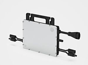

Hoymiles Power HMS-1000-2T HMS Micro-inverter
Hoymiles’ new micro-inverter HMS-1000 series is designed to work with high-powered solar panels, making it one of the best 2-in-1 micro-inverters available. Each micro-inverter can connect up to two panels, with independent MPPT and monitoring that maximizes the power production of your installation. With a maximum DC voltage of 65 volts, Hoymiles micro-inverter is a PV Rapid Shutdown Equipment and conforms with NEC-2017 and NEC-2020 Article 690.12 and CEC-2021 Sec 64-218. The new Sub-1G wireless solution enables more stable communication with Hoymiles gateway DTU, ensuring that you can monitor your system’s performance with ease.
  • Reactive Power Control CA Rule 21 Compliant
  • Compliant with U.S. NEC-2017, NEC-2020 690.12 and CEC-2021 Sec 64-218 rapid shutdown
  • High-powered microinverter for 2-in-1 series with superior performance
  • Safer for rooftop solar stations with PV rapid shutdown compliance
  • With Reactive Power Control, compliant with UL 1741, IEEE 1547, UL 1741 SA, CA Rule21, etc.
  • Independent MPPT and monitoring ensure greater energy harvest and easier maintenance
  • 2-in-1 design enables faster installation
  • Sub-1G wireless solution allows stable communication in commercial and industrial settings
