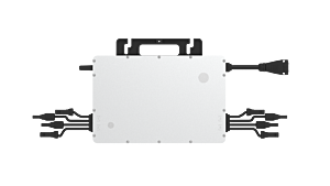

Hoymiles new micro-inverter HMS-2000 series are suitable for high-powered solar panels, which rank among the highest for 4-in-1 micro-inverters.
  • Reactive Power Control CA Rule 21 Compliant
  • Compliant with U.S. NEC-2017 and NEC-2020 Article 690.12 and CEC-2021 Sec 64-218
  • High-powered micro-inverter with output power up to 2000 VA
  • Independent MPPT and monitoring ensure greater energy harvest and easier maintenance
  • With Reactive Power Control, compliant with EN 50549-1:2019, VDE-AR-N 4105:2018, VFR2019, etc.
  • 4-in-1 design enables faster installation and comes with a lower cost
  • Safer for rooftop solar stations with rapid shutdown compliance and isolated transformer
  • Sub-1G wireless solution allows stable communication in commercial and industrial settings
