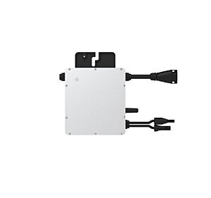

Hoymiles’ new micro-inverter HMS-450 series is designed to work with high-powered solar panels, making it one of the best 1-in-1 micro-inverters available. Each micro-inverter can connect up to two panels, with independent MPPT and monitoring that maximizes the power production of your installation. With a maximum DC voltage of 65 volts, Hoymiles micro-inverter is a PV Rapid Shutdown Equipment and conforms with NEC-2017 and NEC-2020 Article 690.12 and CEC-2021 Sec 64-218. The new Sub-1G wireless solution enables more stable communication with Hoymiles gateway DTU, ensuring that you can monitor your system’s performance with ease.
  • Reactive Power Control CA Rule 21 Compliant
  • Compliant with U.S. NEC-2017, NEC-2020 690.12 and CEC-2021 Sec 64-218 rapid shutdown
  • High-powered microinverter for 2-in-1 series with superior performance
  • Safer for rooftop solar stations with PV rapid shutdown compliance
  • With Reactive Power Control, compliant with UL 1741, IEEE 1547, UL 1741 SA, CA Rule21, etc.
  • Independent MPPT and monitoring ensure greater energy harvest and easier maintenance
  • 1-in-1 design enables faster installation
  • Sub-1G wireless solution allows stable communication in commercial and industrial settings
Input Data(DC):
  • Number of PV inputs: 1
  • Module Power range, typical(W): 400 to 670+
  • Maximum input voltage (V): 65
  • MPPT voltage range (V): 16-60
  • Maximum input current (A): 2x16
Output Data(AC):
  • Peak output power (VA): 1000
  • Maximum continuous output power (VA): 958
  • Maximum continuous output current (A): 3.99 | 4.61
  • Nominal output voltage(V): 240 | 208
  • Nominal output voltage range1(V): 240/211-264 | 208/183-228
  • Nominal frequency/range1 (Hz): 60 / 55-65
  • Maximum units per branch2 (10 AWG) 6 | 5
  • Maximum units per branch2 (12 AWG) 4 | 3
Mechanical Data:
  • Dimensions (WxHxD)inches: 10.28" x 7.09" x 1.38"
  • Weight: 3.2 kg (7.04 lbs)
  • Cooling: Natural convection - no fans
  • Enclosure: Outdoor-IP67 NEMA 6
