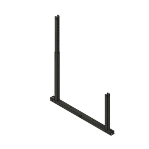

The IR-40FSAB is built from high-strength, black zinc-plated steel and delivers all the performance benefits of IntegraRack's BallastRack systems—plus enhanced tilt adjust ability for region-specific solar optimization. Supporting panel angles from 15° to 40°, it’s ideal for maximizing year-round energy output across a wide range of climates. This versatile mount accommodates solar modules of virtually any size, including today's high-wattage 800W+ panels. Designed for ultra-fast assembly, each frame installs in under two minutes with no need for concrete footings, driven posts, or manual trenching. The system's adjustable tilt and sliding module height make it perfect for snow-prone areas, offering improved ground clearance and efficient snow shedding. Backed by extensive lab testing and a 25-year limited warranty, the IR-40FSAB is a rugged, cost-effective ground mount solution—engineered for speed, strength, and solar performance in even the most challenging terrain, from soft sand to rocky soil.
Key Features:
  • Building Permit NOT Required For Most Installations
  • Constructed From Super Corrosion Resistant Black Zinc Plated High-Strength Steel
  • 15-40° Fixed Adjustable Solar Angle
  • Capable Of Racking Any Size Module
  • 8" of Extra Ground Clearance
  • 2 Minute Assembly Per Frame
  • Lowest Cost Per Watt With Adjustable Angle
  • No Concrete Footings, Post Pounding, or Earth Augers Required
  • Multiple Mounting Options
Included Components:
  • (1) IR-40FSAB Base Tube
  • (1) IR-40FSAB Adjustable Leg
  • (1) IR-40FSAB Short Leg
  • (4) IR-F2 Solar Module Flange Clamp Bonding Brackets
  • (4) M8-1.25 x 90mm Carriage Bolts
  • (4) M8-1.25mm Serrated Nuts
  • (4) M8-1.25 x 16mm Thread Cutting Bolts
