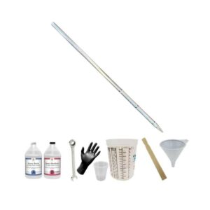

The IntegraRack IR AnchorSpik Kit provides all necessary components to securely install up to 10 solar modules using this innovative mounting option. Each kit includes our uniquely designed 29.5-inch barbed aluminum spikes and a high-strength two-part epoxy. The IR AnchorSpikes feature a hollow design with open barbs, enabling the epoxy to penetrate deeply into the soil, establishing a firm anchor capable of withstanding over 600 pounds of uplift per spike.
Once installed, each IR-30 frame easily clamps onto two AnchorSpikes. The carriage bolts at the ends of the frame can be tightened, allowing for quick and precise leveling of the entire system. It is essential to test the IR-AnchorSpike in the soil at the installation site to verify that it can handle a minimum of 400 pounds of uplift to ensure stability and safety.
The 29.5 inch Anchor spikes can provide up to 1200 lbs in medium / dense compacted soil. The anchor spikes are not recommended for sandy/silty soil types, or rocky soil. We recommend using The Earth ballast option for sandy/silty soil types, or rocky soil.
Mounting Kit Components
  • IR Earth Spikes
  • IR Epoxy Resin A
  • IR Epoxy Resin B
  • Mixing Cup
  • Stirring Stick
  • Funnel
  • Gloves
  • 1/2" Open-Ended Ratchet Wrench
Pack of 10 spikies
