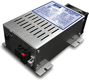

Iota DLS-240-45: 240 Volt AC Input, 12 Volt 45 Amp Battery Charger
Iota Engineering DLS-240-45 45A DC Charger

For charging 12 volt DC batteries or battery banks from a 240 volt AC power source. Features include:
Switch-Mode Technology
Low and Transient AC Line Voltage Protection
Exceptionally Clean DC Output
Reverse Polarity Protection
Proportional Fan Control The DLS-240-45 features a dual voltage jack which allows switching from a long-term float voltage of 13.6vdc to a 14.2vdc rapid charge by simply inserting the dual voltage plug (included) into the jack. The charger can accept input voltages between 220 volts AC and 240 volts AC.
2 year warranty
| SPECIFICATIONS | |
| DC Output Voltage (No Load) approx. | 13.6V (DC) |
| Output Voltage Tolerance (No Load) | + or - .7% |
| Output Amperage, Max Continuous | 45 Amps |
| Output Voltage (Full Load) approx. | >13.4V (DC) |
| Maximum Power Output, Continuous | 600 Watts |
| Ripple and Noise | <50 mV rms |
| Input Voltage Range | 216-264V (AC) |
| Input Voltage Frequency | 47-63 |
| Maximum AC Current @ 216VAC | 5.5 Amps |
| Typical Efficiency | >80% |
| Max Inrush Current, Single Cycle | 30 Amps |
| Short Circuit Protection | Yes |
| Overload Protection | >100% |
| Line Regulation | 100 mV rms |
| Load Regulation | <1% |
| Fan Control | Proportional |
| Thermal Protection | YES |
| Working Temperature Range | 0° -40°C |
| Storage Temperature | -20° to 80°C |
| Withstand Voltage* | 1700/1700/500 |
| Dimensions | 9.7" x 6.7" x 3.4" |
| Weight | 5.0 lbs |
*Primary to Chassis/Primary to Secondary/Secondary to Chassis | |
