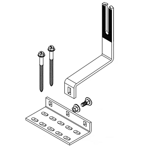

The IronRidge ATH-02-M1 All Tile Hook provides a versatile and strong attachment solution for mounting solar panels on tile roofs. Designed with a mill finish for corrosion resistance, this hook eliminates the need to cut tile during installation, streamlining labor and preserving roof integrity. It includes stainless steel hardware and integrates seamlessly with the IronRidge XR Rail System. The vertical and horizontal adjustability ensures alignment flexibility across various tile profiles, including curved and flat tiles.
Key Features:
  • Compatible with flat, S-shaped, and W-shaped tiles
  • No tile cutting required – install directly on roof deck
  • High-strength aluminum alloy with stainless steel hardware
  • Fully compatible with the IronRidge XR Rail System
  • Vertical and horizontal adjustability for ideal rail alignment
  • UL 2703 listed for grounding and bonding compliance
  • Material: Aluminum (mill finish), stainless steel hardware
  • Weight: 1.6 lbs
  • Dimensions: 7.75” x 1.5” x 7” (approx.)
