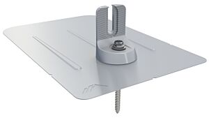

IronRidge FlashVue checks all the boxes when it come to being fully waterproof, fast and easy to install correctly, economical and strong enough to handle every environmental conditions. The optimized flashing design features a large viewport, for easy alignment with the pilot hole. The GripCap and GripCap+ sit snugly in place so the lag can be driven single-handedly.
Features & Benefits:
Right-Sized Flashing
  • 8×12” flashing footprint fits between and avoids most roofing nails.
Large Viewport
  • 0.75” opening in flashing enables easy alignment with the pilot hole.
Elevated Dock
  • Raised viewport platform diverts water and supports GripCap
Friction-Fit GripCap
  • Unlike L-Feet, it stays in place so only one hand is needed to fasten.
360 Placement
  • GripCap installs in NS or EW orientation, or whatever is needed.
Sealing 7/16" Lag
  • Bolt and EPDM washer combo uses same socket size as rest of system.
Includes:
  • One FlashVue Flashing
  • One GripCap
For additional height look at the GripCap+
