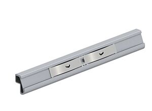

The BOSS procides a strong, bonded connection for XR rails. No assembly, tools, or hardware required. The built-in bonding spring has teeth that bite into rail, creating a connection that meets all UL standards.
The BOSS eliminates restrictions around splice locations. Place it anywhere along the span except the outside cantilever.
Features & Benefits
  • Installs Anywhere: Place into XR Rails anywhere, except the outside cantilever.
  • Tool Free: Single piece, with no assembly, tools, or hardware required
  • Meets UL Standards: Integrated bonding is fully code-compliant with UL 2703
  • Matches Rail Sizes: Splices are available now for XR10 and XR100 Rail sizes.
  • Self-Centering Tab: Centered stop tab provides tactile feedback for proper installations
  • Easy Expansions: No more bonding straps! Just leave a 1″ gap for expansion joints.
