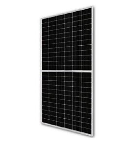

JA D30 Series bifacial modules are assembled with 11BB PERCIUM cells in half cut configuration with glass on front and back. D30 series modules have a slightly larger footprint than D10 series. Module cables are also 1300mm (slightly longer than previous series).
JAM72D30-540/MB Specifications:
  • Power at Mpp: 540 Watts
  • Isc: 13.86 Amps
  • Voc: 49.60 Volts
  • Imp: 12.97 Amps
  • Vmp: 41.64 Volts
  • Efficiency: 20.9%
  • Cell: 144(6x24)
  • Maximum system voltage: 1500 Volts
  • Connector type: MC4
  • Dimensions: 89.7" x 44.6" x 1.38" (35mm)
  • Weight: 70.1 pounds
Warranty: 12 year product warranty, 30 year performance warranty.
