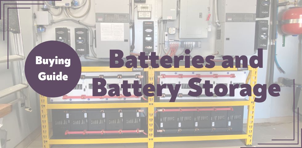

Click on the image to download our buying guide Batteries and battery storage PDF:
Batteries and battery storage Buying Guide
