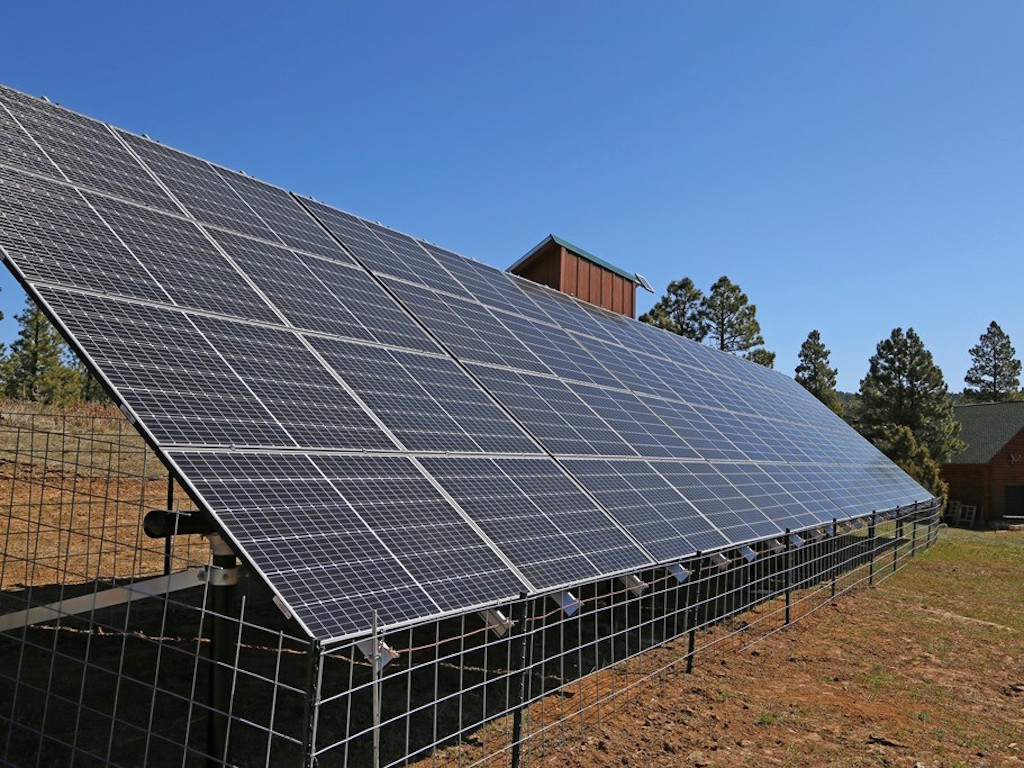

REC Solar 320 Watt N-Peak Monocrystalline Solar Panel Array
Another look at the array setup from behind
