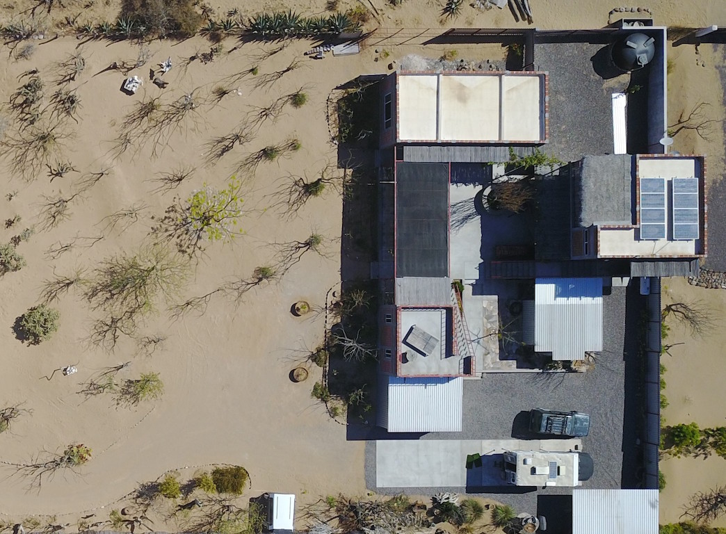

After traveling to Baja regularly for the past 20 years, in 2005 Bob decided to build another home in San Juanico, Baja California Sur which would also need its own solar power system. Given his experience designing and installing his first solar system and putting together a 12-volt system for his 5th wheel trailer, Bob had more than adequate knowledge to properly spec out the power needs for his place in Baja.
Bob knew after doing some calculations how to size his system to run lights, refrigeration, internet, water pumps, TV, ceiling fans and the AC for a couple of hours at night. His goal was to have 80% of the battery storage available every morning to lengthen the life of the batteries so his solar array needed to be large enough to accommodate. Also, he had to keep in mind that his Baja home is 100 miles off road, no services, no skilled electricians and no installers. Bob needed to build a system that would maintain itself and be made to last.
In the past, Bob used AGM batteries that lasted approximately 10 years before they started to decrease in performance. Given that he needed to replace the batteries, he saw it as an opportunity to reach out to Northern Arizona Wind & Sun to ask for advice. He needed a complete turnkey operation due to the lack of electricians in his remote area of Baja. After consulting with our solar engineers, Bob decided to go with a new self-contained OutBack FLEXpower One system with (2) SimpliPhi 3.8 kWh Lithium batteries. Going with a pre-wired system like the OutBack FLEXpower instead of individual components, reduced the amount of time and knowledge needed for wiring the system.
Bob configured the solar system in the United States before driving it down to Baja. He had it installed and running in under 3 hours! He considers it a perfect success story.
