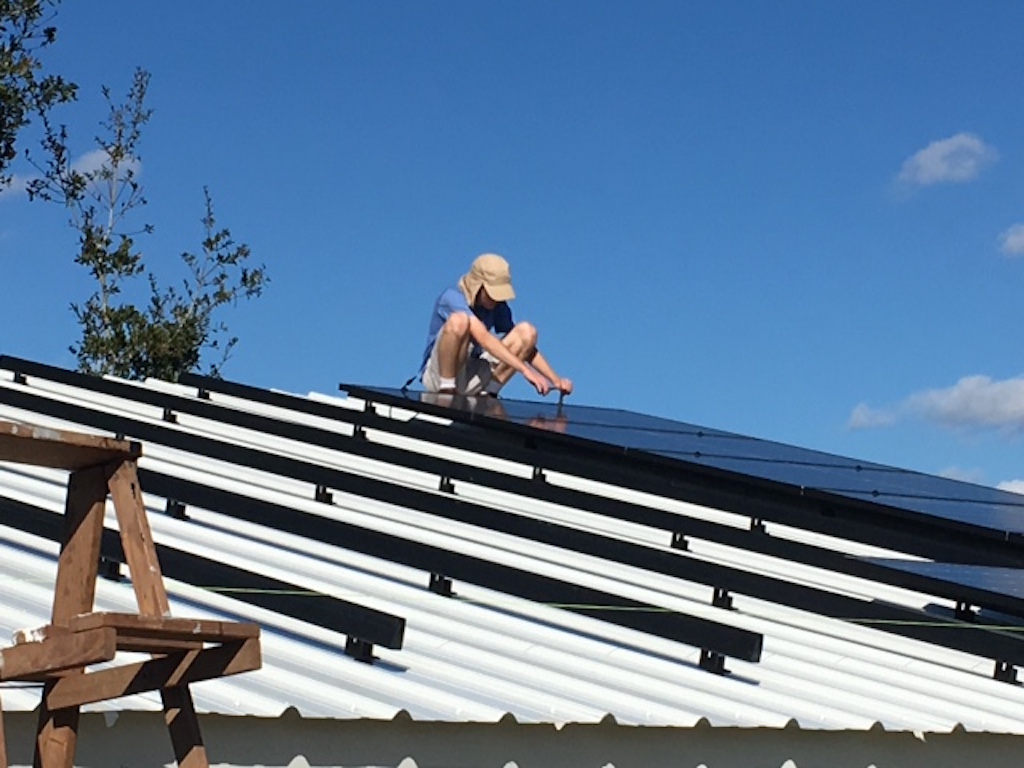

Robert built a shelter for mounting the solar panels
Installing solar panel rail mounts

Robert contacted me about installing a grid-tied solar system at his home in Florida. He planned to install the solar panels on a pole barn next to his house. The pole barn had a unique roof structure which required a slightly different rail configuration and special mounting hardware. There was some back and forth with his inspector/utility in determining the applicable NEC regulations on rapid shutdown, along with a few different solar panel mounting configurations. Although there were multiple design revisions, in the end Robert ended up with an amazing self-installed grid-tied solar system.
When I first spoke with Robert he was honestly a bit of a newbie when it came to solar. However, after a few talks on the phone, it was clear he was eager to learn more. Throughout our conversations over the weeks I could tell he had been educating himself on the subject and retaining what we had been discussing. By the time he had finally got his system delivered, he was definitely ready to take on the installation. Robert’s DIY install turned out great, and he exceeded the expectations of the inspector along with utility company personnel. He was determined to get everything perfect down to the last detail, and I think he nailed it! Overall great customer to work with and a very clean installation.
Robert’s system consists of an 8.2kW PV array with REC solar panels, connected to a SMA Sunny Boy 7.7kW grid-tied inverter. The solar panels are mounted on a pole barn using IronRidge mounting hardware. He is utilizing the Secure Power Supply feature on the Sunny Boy inverter which provides to 2kW of usable power via solar during a daytime grid outage.
