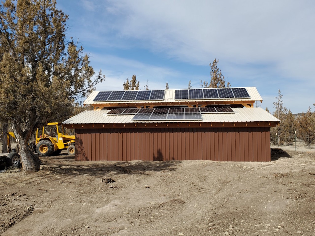

Being that Larry didn’t have much electrical experience, Logan suggested for him to go with the OutBack Radian which combines all the components in a pre-wired fashion into one unit to make the integration simpler. Another obstacle was figuring out a mounting system for Larry’s solar panels. He opted to build a pole barn that’s south facing to get the most exposure to the sun as possible and large enough to house all his solar panels. He was able to reduce cost by mounting them on a structure he was going to use for storage anyway. Logan suggested going with a solar panel rail system that adheres to the roof.
Now that Larry had all the components he needed, it was time to get everything installed and wired. He built a small 8x8 building with 2x6 studs on one side (16” on center) to support the weight of the OutBack Radian which weighs around 250 lbs. Once it was mounted, he connected it to his Discover Lithium Battery bank. He made a lengthy run from the shed to the pole barn where the panels are mounted. Now that everything was installed Larry called Logan again to help him program the system and monitor it over the internet.
After everything was said and done, Larry was impressed with how well the system performed during the summer. They had plenty of power to run the AC and watch some TV in the evening. Once winter hit, Larry quickly realized that he needed to buy another Discover Lithium Battery for his system because of the reduced amount of solar exposure during that time of the year. Logan stepped in and helped him re-program the system to accommodate the new battery addition, which increased his ability to store more energy.

8x8 shed that houses the inverter and batteries
Power run back to the barn
