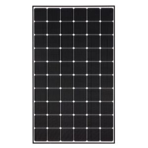

LG LG335N1C-A5-AWB 335 Watt Monocrystalline Solar Module with Black Frame
LG solar panels are known for durability, performance, efficiency, and high power output. LG manufacturers some of the most efficient and highest quality solar modules in the world. This module uses a more advanced double-sided solar cell, which also produces energy from reflected light off the rear of the module. The reinforced frame and the module's ability to withstand up to 6000 Pa led LG to increase the term of the warranty, for a total of twenty-five years product warranty. The power warranty promises 86% of rated power after a period of 25 years. If you're looking for top quality and performance, the LG brand of modules is likely what you are looking for.

  • Module power: 335 Watts
  • Number of cells: 60
  • Power tolerance: -0/+3 Watts
  • Vmp: 34.1 Volts
  • Voc: 41.0 Volts
  • Imp: 9.83 Amps
  • Isc: 10.49 Amps
  • Module efficiency: 19.6%
  • Dimensions (inches): 66.38" x 40.0" x 1.57"
  • Dimensions (mm): 1686 x 1016 x 40
  • Weight: 39.68 lb.
