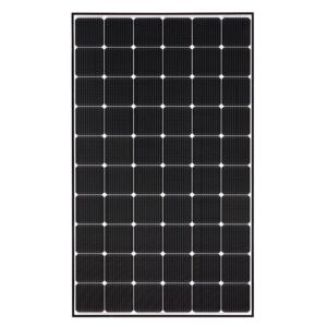

LG solar panels are known for durability, performance, efficiency, and high power output. LG manufacturers some of the most efficient and highest quality solar modules in the world. This module uses a more advanced double-sided solar cell, which also produces energy from reflected light off the rear of the module. The module can withstand up to 5400 Pa from the front and up to 4000 Pa from the rear. The power warranty promises 89.6% of rated power after a period of 25 years. If you're looking for top quality and performance, the LG brand of modules is likely what you are looking for.
LG335N1C-V5 Specifications:
  • Module power: 335 Watts
  • Number of cells: 60
  • Power tolerance: -0/+3 Watts
  • Vmp: 34.1 Volts
  • Voc: 41.0 Volts
  • Imp: 9.83 Amps
  • Isc: 10.49 Amps
  • Module efficiency: 19.6%
  • Dimensions (inches): 66.38" x 40.0" x 1.57"
  • Dimensions (mm): 1686 x 1016 x 40
  • Weight: 37.7 lb.
Warranty: 25 year product warranty, 25 linear power warranty
