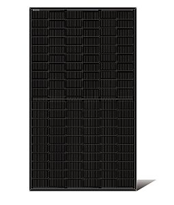

LONGi LNG-355-LR4-HPB 355W Monocrystalline Module
The LONGi HPB Series combines High Efficiency, Low LID Mono cells with Half-cut Muti Busbar Technology to improve performance and boost production. 35mm frames reduce weight while still providing the strength and resilience needed to rate 5400Pa for front side static loading and 2400Pa for rear side static loading.
Feautes:
  • Suitable for distributed projects
  • Advanced module technology delivers superior module efficiency
  • Excellent outdoor power generation performance
  • Aesthetic appearance with all black module design
  • Nominal Power: 355 Watts
  • Watt Class Sorting: -0/+5
  • Vmp: 34.6 Volts
  • Imp: 10.27 Amps
  • Voc: 40.6 Volts
  • Isc: 11.25 Amps
  • Panel Efficiency: 19.5%
  • Dimensions: 69.09" x 40.86" x 1.37" (35mm)
  • Weight: 42.99 lbs.
