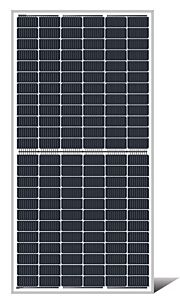

LONGi LNG-445-LR4-72HBD 445W Mono PERC Module
The LONGi HPH Series combines High Efficiency, Low LID Mono PERC cells with Half-cut Muti Busbar Technology to improve performance and boost production. This module series has a max system voltage of 1500V and is Fire Rated as Class C (per UL790). 35mm frames reduce weight while still providing the strength and resilience needed to rate 5400Pa for front side static loading and 2400Pa for rear side static loading.
Front side performance equivalent to conventional low LID mono PERC. Bifacial technology enables additional energy harvesting from rear side (up to 25%). Glass/glass lamination ensures 30 year product lifetime. Solid PID resistance ensured by solar cell process optimization and careful module BOM selection. Reduced resistive loss with lower operating current.
Feautes:
  • High module conversion efficiency: (up to 20.3%)
  • Positive power tolerance: (0~+5W) guaranteed
  • Slower power degradation: Enabled by Low LID Mono PERC technology
  • Solid PID resistance Ensured by solar cell process optimization and careful module BOM selection
  • Reduced resistive loss with lower operating current
  • Higher energy yield with lower operating temperature
  • Reduced Hot Spot Risk with optimized electrical design
  • Nominal Power: 445 Watts
  • Watt Class Sorting: -0/+5
  • Vmp: 41.2 Volts
  • Imp: 10.80 Amps
  • Voc: 49.4 Volts
  • Isc: 11.52 Amps
  • Panel Efficiency: 20.5%
  • Dimensions: 82.44" x 40.8" x 1.37" (35mm)
  • Weight: 60.6 lbs.
