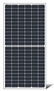

The LONGi HPH Series combines High Efficiency, Low LID Mono PERC cells with Half-cut Muti Busbar Technology to improve performance and boost production. This module series has a max system voltage of 1500V and is Fire Rated as Class C (per UL790). 35mm frames reduce weight while still providing the strength and resilience needed to rate 5400Pa for front side static loading and 2400Pa for rear side static loading.
Feautes:
  • High module conversion efficiency: (up to 20.3%)
  • Positive power tolerance: (0~+5W) guaranteed
  • Slower power degradation: Enabled by Low LID Mono PERC technology
  • Solid PID resistance Ensured by solar cell process optimization and careful module BOM selection
  • Reduced resistive loss with lower operating current
  • Higher energy yield with lower operating temperature
  • Reduced Hot Spot Risk with optimized electrical design
  • Nominal Power: 450 Watts
  • Watt Class Sorting: -0/+5
  • Vmp: 41.5 Volts
  • Imp: 10.85 Amps
  • Voc: 49.3 Volts
  • Isc: 11.60 Amps
  • Panel Efficiency: 20.7%
  • Dimensions: 82.44" x 40.8" x 1.37" (35mm)
  • Weight: 51.82 lbs.
