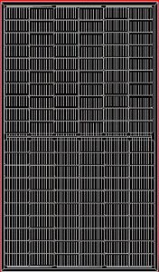

LONGi LR4-60HPB-350M Hi-MO4m
LONGi is a leader in the solar PV industry pushing new heights with product innovations and optimized power-cost ratio with breakthrough monocrystalline technologies.
Half-cut cell technology is to cut the cell into two separate parts by mature infrared laser, hence halve the working current. The thermal loss on the ribbon will be remarkably reduced and the module’s power increases by 2%. The reliability of module is also enhanced.
  • High module conversion efficiency: (up to 20.3%)
  • Positive power tolerance: (0~+5W) guaranteed
  • Slower power degradation: Enabled by Low LID Mono PERC technology
  • Solid PID resistance Ensured by solar cell process optimization and careful module BOM selection
  • Reduced resistive loss with lower operating current
  • Higher energy yield with lower operating temperature
  • Reduced Hot Spot Risk with optimized electrical design
  • Nominal Power: 350 Watts
  • Watt Class Sorting: -0/+5
  • Vmp: 34.4 Volts
  • Imp: 10.18 Amps
  • Voc: 40.4 Volts
  • Isc: 11.16 Amps
  • Panel Efficiency: 19.2%
  • Dimensions: 69.1" x 40.8" x 1.37" (35mm)
  • Weight: 43 lbs.
