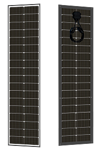

Lumera Solar 140 W Bifacial 12V Solar Panel
The Lumera Solar 140W “Long and Skinny” bifacial solar panel delivers powerful performance in a sleek, space-saving design—perfect for tight installations on RVs and boats. By capturing reflected light and generating power from both sides, it can produce up to 30% more energy, maximizing output per square foot. Built with advanced PERC cell technology, every panel undergoes a rigorous four-step quality control process and is assembled using state-of-the-art robotics.
This panel features a compact design with dimensions of 15.35" x 67.52" x 1.38" and weighs approximately 19.95 lbs, making it easy to install in various setups. The advanced glass and cell technology used in this panel enhances its durability and efficiency, ensuring a longer lifespan and higher energy output over time.
  • Nominal Power: 140 Watts
  • Watt Class Sorting: -0/+5
  • Vmp: 19.8 Volts
  • Imp: 7.05 Amps
  • Voc: 22 Volts
  • Isc: 8.2 Amps
  • Panel Efficiency: 21%
  • Dimensions: 15.35" x 67.52" x 1.37" (35mm)
  • Weight: 20 lbs
