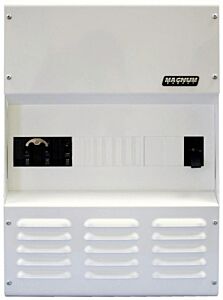

Magnum Panel MPSH175-30D for Three Inverters
Note: Out of the box, this Magnum panel will accommodate only one MS-PAE inverter. If you plan to use it for three MS-PAE inverters stacked in parallel, you will also need the optional MPX extension boxes, the MPXS175-30D-L and MPXS175-30D-R.
Note: Picture #2 shows the MPSH175-30D with all the installed options.
The MP (Magnum Panel) enclosures have been specifically designed to combine all of the major components required for a high power renewable energy system - inverter/battery disconnect, AC overcurrent protection, grounding connections, and a full system inverter bypass switch as a convenient way to isolate the inverters for battery maintenance - into easy to install pre-wired enclosures. Designed for multiple inverter applications, the MP Series enclosures feature convenient front panel operation, and with the optional Router (ME-RTR), will allow you to easily set up, monitor, and operate up to four MS-PAE inverter/chargers together (must be identical models to parallel stack). In addition to saving time and money by providing a simple and convenient inverter installation, the MP enclosures ensure safety and reliability by providing a UL and CSA certified and code compliant system.
