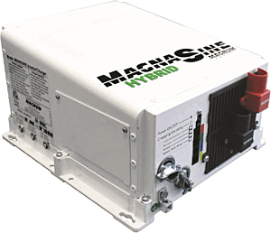

Magnum Energy Pure Sine Wave MSH4024RE Hybrid Inverter, 4000 Watts, 24 VDC
NOTE: We are an authorized Magnum Energy dealer. Be careful when browsing the internet for deals on Magnum equipment. According to Magnum's policy, the warranty on equipment purchased from unauthorized dealers is null and void. If you see a price that looks too good to be true, it probably is.
The Magnum Energy MSH-RE series hybrid inverter is designed for off-grid and backup power systems. The pure sine wave 60Hz, 120 volt output ensures that you can run all standard 120 volt devices. It has two separate AC inputs, one for a generator and one for utility power. This allows you to charge your batteries from either AC source. The hybrid function of this inverter is what makes it stand out. If you have a total electrical load that exceeds the inverter output, the inverter can start your generator and match its AC output with the inverter's AC output. Instead of running all loads from the generator, it combines the generator output with the inverter output. So if your generator is rated for 2,000 watts and you add that to the 4,000 watts from the inverter, you can run a total of 6,000 watts of electrical loads.
