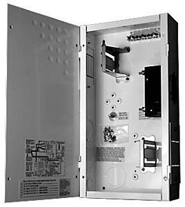

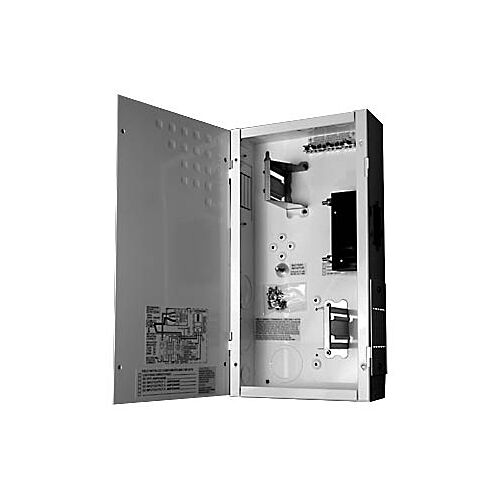

White aluminum chassis with 250A/125VDC breaker. 10" x 5" x 18" The MNDC250PLUS comes with a din rail for five additional DC circuit breakers for DC loads, charge controller disconnect, battery status monitor feed etc. Included is a ground bus, 5/16" bonding battery minus stud. Mounting holes for a 500 amp shunt are built in. The Mini-DC is designed to t ake into account many different types of renewable energy installations. The installation instructions will describe and show some of the most common possibilities.
  • The PLUS units come with an extra DIN rail for mounting additional DC breakers
  • Aluminum chassis. (no rust in the tropics or around salt water)
  • Hinged door for easy access to electrical circuits
  • Inverter breaker included (125, 175 or 250 amp)
  • Din rail for DC circuits such as PV in, Chg Cntrl out, DC-GFP, DC loads, PV combiner
  • Ground bus bar with 14 poles
  • Six mounting spots for 500 amp, 50mV shunt
  • Mounting spot for insulated bus bar (for PV negative connection point)
  • Knock outs for inverter and battery cables, charge control mounting, DC & PV in & out
  • 5/16" diameter stud for battery negative tie point
  • ETL listed for US and Canada
