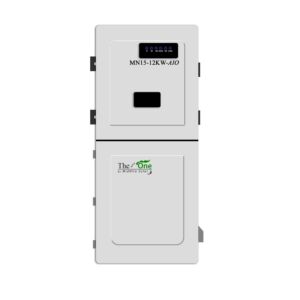

MidNite MN15-12KW-AIO All in One inverter
The MidNite MN15-12KW-AIO All In One Inverter exemplifies innovation from a trusted industry leader. This 11,400-watt system features three powerful MPPT charge controllers and three programmable 120/240VAC outputs for load shedding or opportunity loads. Continuing MidNite's legacy of industry-shaping products, the AIO incorporates unique features not found in other inverters.
The AIO's three integrated 120/240VAC outputs can replace an external programmable distribution box, significantly reducing installation costs. Heavy-use loads can be controlled based on user-defined parameters, offering unparalleled flexibility. The AIO supports the full 600VDC allowed by the NEC, compared to the 500VDC limit of most inverters, enabling more powerful arrays to meet your energy needs.
Real-time monitoring and control are available through a web-based app and the built-in display, allowing you to view system performance online. MidNite remains committed to delivering innovative, reliable products with ongoing adaptations based on customer feedback.
  • 30A, 50A & 60A 120/240VAC Branch Circuit Breakers With Programmable Relays For Load Shedding And AC Inputs For Generator And AC Coupling.
  • Three 15 Amp And One 20 Amp 120V AC Load Breakers
  • UL1741SB Sell To Grid, Self Consumption With CT’s Or Off Grid Mode
  • Residential And Commercial
  • Up To 200% Oversizing Allowed With 3 MPPTs
  • Supports Up To 30A PV Input Current
  • Supports AC Coupling
  • Supports Self-Consumption
  • Works With Our Standard Battery Temp Sensor MNBTS NOT Included.
  • Arc Fault, Ground Fault And Rapid Shut Down Included
  • 100A AC Pass Through With Input And Output Breakers For NEC Compliance
  • All AC And DC Breakers Are Magnetic Hydraulic Allowing For 100% Continuous Duty
  • 250 Amp CBI Magnetic Hydraulic Battery Breaker
  • Supports 40-64VDC Lithium Or Lead-Acid Battery
  • Maximum Battery Charge/Discharge Current Of 210A
  • Stable Output Power
  • Continuous 100% AC Power (11.4KW With PV, 10Kw Without PV)
  • Unbalance Load Surge
  • Supports 120/240/208VAC Connections
  • Seamless Backup Transition (<10ms)
  • Stackable Up To 9 Units
  • Standby Generator Connection For Whole-Home Back Up
  • Remote Configuration And Upgrade
  • 10 Year Warranty
  • Max. Efficiency (PV To AC): 98.0%
  • Max. Efficiency (BAT To AC): 94.5%
  • Max. PV Input Power: 15,000W Max.
  • PV Voltage: 600V
  • Start-Up Voltage: 90V
  • MPPT Operating Voltage Range: 70V-550V
  • Max. Input Current Per MPPT: 30A/22A/22A
  • String (Per MPPT): 6(2/2/2)
  • Number Of MPPTs: 3
  • Battery Type: Lithium-Ion/Lead-Acid Or Other
  • Nominal Battery Voltage: 48V
  • Battery Voltage Range: 40V-64V
  • Max. Charge/Discharge Current: 210A/210A
  • Grid Frequency Range: 45Hz-55Hz/55Hz-65Hz (Adjustable)
  • Power Factor: 0.99 @Rated Power (Adjustable 0.8 LG - 0.8 LD)
  • THDI: 3% (Rated Power)
  • Nominal Output Power: 11.4KW Continuous
  • Nominal Output Current: A/47.5A
  • Peak Output Apparent Power(1s): 20,000VA (13,000VA Per Leg)
  • Nominal Output Voltage: 120/240V (Split Phase) / 208V (2/3 Phase)
  • Nominal Output Frequency: 50 Hz /60Hz
  • Transfer Time: <10ms
  • THDV: <3% @100% R Load
  • DC Switch: YES
  • AC Overcurrent Protection: YES
  • DC/AC Overvoltage Protection: DC Type II, AC Type III
  • AC Short Circuit Protection: YES
  • DC Reverse Connection: YES
  • Surge Arrester: DC Type II, AC Type II
  • Insulation Resistance Detection: YES
  • Leakage Current Protection: YES
  • AFCI: YES
  • RSD: Yes (APsystems Sunspec Transmitter Built In)
  • Generator: YES
  • Max. Operation Altitude: 6500FT / 2000M
  • Ingress Protection Degree: IP65/NEMA 3R
  • Operating Temperature Range: -25~60C(>450 Derating)
  • Relative Humidity: 0~100%
  • Cooling Method: Fan Cooling
  • Mounting: Wall Bracket
  • Dimensions (W*H*D): 16.5W X 38.3L X 10.27D Inch (420mm X 973mm X 261mm)
  • Weight: 44.45Kg/98Ib
  • PV Connection: Spring Terminals
  • Display: Wireless & APP + LED , LCD (Optional)
  • Communication Interface: RS485/CAN (For BMS), DRM/RS485 (For Meter), RS485
  • Optional: WiFi /LAN
  • Agency Approvals: UL1741SB, IEEE1547: 2018, HECO SRD 2.0 UL 1741/CSA C22.2/UL 1699B
  • EMC: FCC Part 15 Class B
