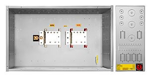

Image shows optional 3rd BUS BAR.

Includes a 2000 Amp positive and negative bus bar with 3/8 inch studs. Cables can be double lugged and the copper bus bar can be drilled for additional mounting locations, We recommend you use 3/8 inch stainless bolts if you drill holes to attach more ring terminals. Includes a 2000 Amp 200mV shunt with 1/2 inch bolt for customer connection (SMA uses 50mv shunt). It has locations for up to 12 1” MNEDC Breakers, MNBREAKER ADAPTER can be used to adapt down to accommodate ¾” breakers. Powder coated steel.
Useful for dual Radian inverters as well as for combining multiple strings of batteries.
  • Max. AC Voltage - 277VAC
  • Max. DC Voltage - 300VDC
  • Max. Wire Size - 4/0
  • Number of Spaces - 12
  • Environment Rating - Type 1 environmental rating (indoor)
  • Product Dimensions: 35-1/2" L x 22" W x 9-3/4" D
  • Product Weight: 50lbs
  • Warranty - 5yrs
  • Made in USA
