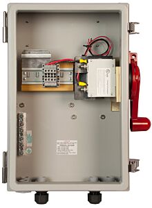

MidNite Solar MNSOB4X-2P Two-Pole DC Disconnect Switch
NEMA 4X aluminum enclosure (no rust, won't turn to dust). MNSOB4X-2P is a disconnect switch. It has a 2 channel switch that breaks both the positive and negative of a PV string to a transformerless inverter. It has a combined rating of 600v and 20 amps as shipped. The switch is good for 100amps but the wire and terminal blocks limit it to 20 amps.
Features and Specifications:
  • Disconnect has built in shunt trip with positive feedback
  • Birdhouse compatible
  • Optional PV connected power supply
  • See thru deadfront
  • Type 4X aluminum enclosure (no rust, won’t turn to dust)
  • Load Break Rated
  • 90o C connections
  • Meets NEC 2011 and 2014 NEC 690.12
  • Two 1/2" strain reliefs (MNSR-1000), six hole plugs (MNHOLE PLUG 1/2) and a wrench (MNWRENCH) are included
