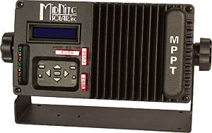

MidNite Solar The Kid Marine MPPT Charge Controller in Black
NOTE: The Marine version of The Kid comes with the mounting bracket, 4 ft of flex conduit, battery temperature sensor, and an extra conformal coating.
IMPORTANT: Input, output, and load negatives must be isolated. They are not internally connected. Inaccurate current readings and damage may result from improper wiring. Load Positive is internally connected to Battery Positive. Loads are switched in the negative leg.
THE KID IS CERTIFIED TO UL1741 & UL458 (MARINE SUPPLEMENT)
With the UL458 marine supplement, THE KID meets very strict vibration, environment, and thermal requirements.
Comes standard with marine mounting bracket. Model number MNKID-M-B for the Black marine and MNKID-M-W for the White marine version. The marine versions can be cut into the wall for a flush mount assembly and also comes with a marine mounting bracket.
