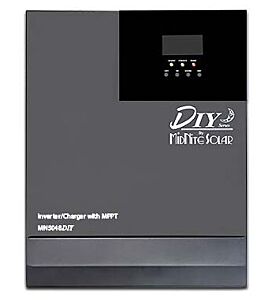

Offering a simple, all-in-one installation and flexible programming, the new MidNite Solar Inverter/charger DIY Series will charge virtually any battery chemistry. With excellent surge capability, the DIY Series will start the most demanding 120VAC loads. Perfect for your off-grid cabin or house, the DIY Series is designed to be affordable, dependable, and supported by the industry’s best customer service personnel at MidNite Solar.
