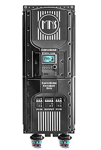

The MidNite Solar Barcelona (MNBCLNA-PW) is a powerful 200-amp MPPT charge controller designed for large-scale battery-based renewable energy systems. Built for both off-grid and grid-tied DC-coupled installations, the Barcelona delivers exceptional solar harvesting performance with dual independent MPPT tracking and a wide PV operating window.
With 100 amps per MPPT channel, the Barcelona can efficiently manage large solar arrays while maximizing power production. Its MPPT operating window of 185–585V and ideal PV input range of 300–600V provide flexibility when designing higher-voltage solar arrays.
The controller features an integrated MNGP2 graphical programming and monitoring interface with a rotary push-button control, making configuration simple and intuitive. When paired with MidNite inverters and other MidNite devices, the display provides centralized monitoring and communication through CANbus, eliminating the need for additional displays.
