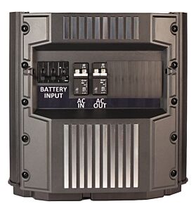

The MidNite Solar MNE300ROSIE-240F is a follower E-panel for dual Rosie inverter systems. This E-panel has a 300 amp high-capacity DC circuit breaker specifically designed for connecting 48V nominal battery to the MidNite Solar ROSIE inverter. Has 60 amp AC input and output breakers for the Rosie inverter. This E-panel has no bypass breakers.
Engineered to integrate seamlessly with MidNite’s ROSIE platform, the MNE300ROSIE-240F supports safe and efficient system operation by protecting critical AC circuits. Its robust construction ensures long-term durability in both residential and commercial energy storage setups.
  • Terminal block to attach optional MidNite Solar Surge Protection Devices
  • Styled to match the MNROSIE7048 inverter/charger
  • 80VDC, 300A, battery positive circuit breaker
  • 60A AC IN and AC OUT circuit breakers
  • NO Bypass circuit, Included in the Primary or external by installer
  • Breaker assembly
  • Optional backplate for mounting
  • Ground busbar
  • Listed to UL1741
