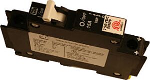

Midnite Solar 150 volts, 4 amps DC circuit breakers for array combiners or any other DC applications. These are most commonly used in array combiners, but are suitable for any DC circuit up to 150 volts, such as DC distribution and small inverters. These mount on any standard 35mm DIN rail.
13mm [.5"] wide, not UL listed for AC. These breakers will accept wire from #14 AWG to #6 AWG stranded copper.
For E-Panels, MNDC, Combiners and Baby Box enclosures. These are standard DIN rail mount, and fit nearly all array combiners, including Outback Power, Midnite Solar, and ReadyWatt.
Midnite Solar breakers and the Outback Power PV array breakers are identical and may be used interchangeably.
