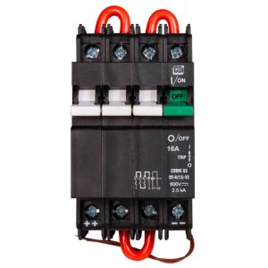

MidNite Solar MNEPV16-600RT Remote Trip Circuit Breaker 16 Amps
MidNite Solar MNEPV16-600RT Remote Trip Circuit Breaker 16 Amps and 600 Volts DC
The MidNite Solar MNEPV16-600RT remote trip circuit breaker is rated for 16 amps and 600 Volts DC. It's designed to work with the MidNite Solar Birdhouse rapid shutdown system and the disconnecting combiner boxes. Mounts to standard DIN rail.
This breaker has the Remote Trip feature that allows it to work with our Battery Disconnect Module ( MNBDM-24 or MNBDM-48 ) and the Rapid Shutdown system.
- Environmental Rating - Type 1 (Indoor)
- Breaker Torque Value: 20 In-Lbs (2.3NM)
- Current Rating - 16A
- DC Voltage Rating - 600VDC
- Wire Size Range - 14 to 6 AWG
- Width - 2 inches
- Number of poles - 4
- Listed for US
5 year warranty
| SKU | MNEPV16-600RT |
