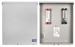

MidNite Solars MNLBC is a 14 string disconnecting lithium battery combiner.
  • Combines up to 14 strings of batteries
  • Rated for up to 80 volts DC mazimum
  • 250 amps maximum
  • 250 amp weather proof disconnect built in
  • 10 each 3/4 inch knock outs for cable entry
  • 2 each 2 inch knock outs for cable entry
  • 2 output studs 5/16 each
  • Type 3R aluminum powder conated enclosure
  • Dimensions: 21" x 16.5" x 3.5"
  • 5 year warranty
