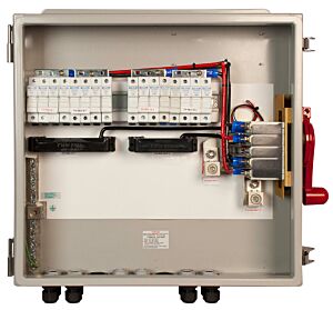

NEMA 4X aluminum enclosure (no rust, won't turn to dust). Eight strings into the combiner with two separate 60 amp strings out. Specifically designed for the new dual channel MPPT on the transformer-less inverters. This configuration will break the Positive and Negative of 2 separate 600vdc strings.
The difference between the regular Disco combiner and the DLTL version is that the MNPV16HV-Disco-4X is made for a single 16 string inverter, two 8-string inverters, or one 8-string transformerless where as the DLTL is set up for eight strings in and two strings out for Dual MPPT on transformerless inverters.
Features and Specifications:
  • Rapid Shutdown System compliant
  • Birdhouse compatible
  • Type 4X aluminum enclosure (No Rust)
  • Number of Fuse Holders (MNTS) included - 16
  • Fuses included
  • Current Rating - 120A
  • Max. Output Wire Size - 2/0
  • Output Circuits - 2
  • 90 degree C connections
  • 1/2 strain reliefs (MNSR-1000) included
  • Meets 2014 NEC 690.12
  • See through dead front and color coded bus bar guards
  • #6 AWG internal wiring
  • Warranty - 5 yrs.
  • Listed by ETL for US & Canada
  • Made in the USA
Dimensions: 21.6"L x 19.9"W x 5.8"D (including handle)
Weight: 25 pounds
