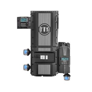

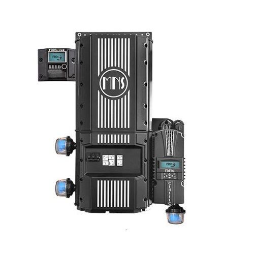

The Rosie is the most versatile inverter/charger in its class. Ideal for Medium renewable energy systems. The Rosie Inverter/Charger is a battery-based, DC-to-AC inverter and AC-to-DC charger for off grid and mobile system. The MNROSIE7048RE is a 7000-watt inverter/charger with 60-amp AC transfer relay and 120-amp, multi-stage PFC battery charger. The AC IN and OUT have common Neutrals for use in renewable energy (RE) systems (homes/cabins). The AC Neutral and Ground do not have an internal bond. The bond must be made in the AC system (commonly at the AC service panel).
The MNGP2 graphics and programming module allows communication, monitoring and programming of all future MidNite products (Hawke's Bay, Barcelona and Rosie for example) from a single unit. The rotary dial provides easy access to all menus and devices on the network as well as the selection of custom programming within the various sub-menus
The Rosie E-Panel is an AC and DC enclosure offering over-current protection (OCP) and disconnects for AC IN, AC OUT, and to the battery bank. The E-Panel is designed specifically for the MidNite Solar MNROSIE7048 inverter/charger but may be used with any 120/240VAC inverter at 60A AC IN and OUT and 65VDC/100A out.
