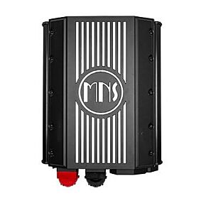

Introducing MidNite Solar latest innovation in power technology - MidNite Solar sleek and stylish Rosie inverter, designed and made right here in the United States. Powered by the latest silicon technology, this powerhouse can surge up to 3X its rating, yet remains incredibly lightweight, making it easy for a single person to install.
Not only does the Rosie inverter deliver exceptional performance, it perfectly pairs with any of MidNite Solar MPPT chargers to create a seamlessly integrated and visually stunning power system. Together, they deliver an unbeatable combination of power and efficiency, Trust in the reliability and sophistication of MidNite Solar new inverter/charger to take your power system to the next level.
Rosie Mobile has all the same features and performance of MidNite Solar standard RE Rosie with the addition of a neutral to ground bond switching relay and UL458 listing.
The MNGP2 must be purchased separately to configure and setup the inverter
  • Neutral to ground bond switching internally
  • 120v input auto sense for RVs that connect to 50A 120/240 or 30A 120
  • Provides 120 or 120/240VAC output in one unit
  • 7000 watts / 48 volt DC
  • 120 amp charger
  • 2 aux input/outputs
  • True sine wave inverter with charger
  • Listings: UL1741, UL458 & CSA
  • Screened (gecko/mud dauber proof)
  • Quiet forced air cooling over heat-sink fins and transformer compartment
  • SOC monitoring with MidNite Wizbang Jr. and MNGP2
  • Die cast aluminum enclosure
  • Auto gen start (two-wire generators)
  • BTS included
  • Remote battery voltage sensor
  • Canbus communications
  • Listed to UL1741 and UL458
  • Built in Arlington, WA USA
  • Part Dimensions: 13-15/16" W x 20-9/16" L x 8" D
  • Shipping Dimensions: 18" W x 23-1/4" L x 12-1/4" D
